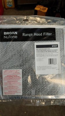

I just made this filter today and going to try it out. The factory (geno's) filter was a no-go on my Mega cab, restricted the already poor air flow way too much to be usable.
This is a range top filter with a thin charcoal foam sandwiched in between. I cut it down to the size of the factory filter. I can still see through the filter so hoping the air flow restriction will be minimal but still offer a little filtering. My goal is to keep the crap from getting in there and clogging up the evaporator/heater core.
View attachment 203366 View attachment 203367 View attachment 203369
Nice job redoing the edges :) Good idea

Nice job refitting
I ended up putting a little duct tape around the edges in the end just to help keep it all together. Those filters frames are originally all one piece with only 1 open end but I had to cut it up into 4 individual pieces.
