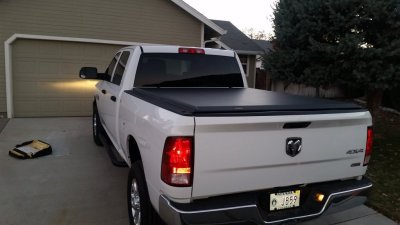

I am like most everyone else on here who has posted about opening another window. I've installed window vent caps or covers on all four doors. In city driving they help deflect wind from rushing in too strongly, but at highway speeds I crack open the front passenger side and the left rear side a little for good open air ventilation. At highway speeds if I open the drivers side window, I get a little too much road noise for my liking. I'm posting a couple of before and after pics of the window vents but I'll try and get better pics of the vents later this week.
