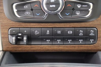

not sure what you have but mine is a big horn so only have buttons across the top and bottom is unfilled so I can switch it out with something like this im hoping2018-ram-ram-2500-crew-4x4-pickup-44.png.jpg

You can get a aftermarket auxiliary switch kit like I have but its 5 switchs not 8. This is the 3rd wiring change in my truck and love it due to oem look.
The one b4 this was a 4 chanel remote sender I had synced to the homelink buttons. Maybe do a combo to accommodate your needs

I think the optional Mopar up lifter switches are the cleanest looking. I needed some switches as well and after researching what it took to add those I went another route. I went with the Spod system and could not be happier. It is pricey, but everything is very well made in this Country, and it is "plug & play. I believe i AEV has a nice system as well, but it places the switches high on the dash which I did not care for. This is the first time I have seen the Rough Country system, and that looks pretty nice and a whole lot cheaper then my Spod. I could not tell if the switches are back lit, or light up when activated on the Rough Country which is a nice feature on the Spod.
