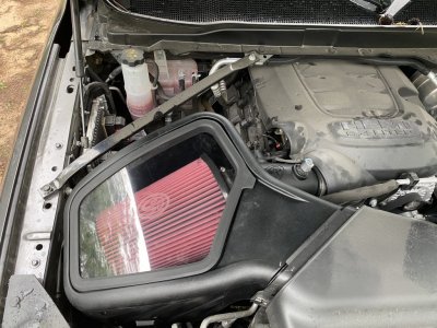

Intake delivered and installed. Initial thoughts: everything looks good. The new silicone lids they make now are an absolute bear to install. Took me a good 15 mins and I ended up pressingnrhe center of the lid and it finally snapped in. I'll give more feedback once I drive it. They recommend leaving the battery off for 2 hours.20200319_163821.jpg

I have the S&B on my 19 and it sounds really good at about 3000rpm plus. After a couple of days driving it I think it has better throttle response and acceleration but that is probably just me.

I haven't had much time to test her out. Did you find the lid to be a complete pain in the keister?

the lid is horrendous, I fought mine as well. Used a bit of grease that seemed to help. The worst part though is the battery disconnect. I have the 12” Uconnect and when I reconnected the battery it lost its mind. No cameras, no A/C. Has to let sit overnight with battery connected for everything to come back.

This is the 2nd drive around the block with this new intake. I get this weird surging going on. Also when I let off the gas it feels like the whole truck just falls on its face.

I have put a couple hundred miles on mine and I have not had either of these issues. If you don’t ‘clock’ the intake runner into just the right position it doesn’t seem like it fully engages the throttle body, not sure if it would cause your issues though.

I do remember getting the intake runner over the throttle body wasnt an easy as "push from the inside" as their install video mentioned. It's possible I didnt leave the battery disconnected long enough
