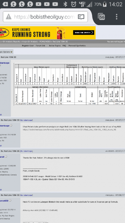

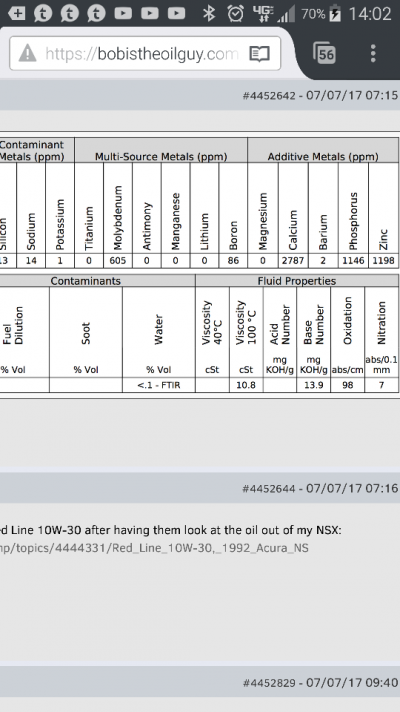

This is screenshots of the VOA of Redline 10W-30 posted above by SyN via bitog .
TBN = 13.9 ! Highest I've ever seen !
b5770d5da7208371428ae424413d5fec.png9ca5dc086457c38a7d5464e635731692.pngdd75b636a6e95daa9f17e07e74fce684.png
Also has more Molybdenum , Phosphorus, Zinc & Calcium than RL 5W-30 ....This is why my next oci will be a 50 /50 mix of RL 5W-30 & RL 10W-30 and likely will be my year round oci unless something changes .
