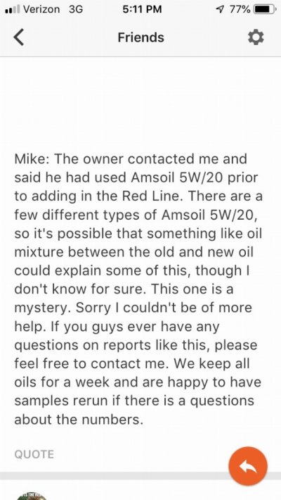

Speaking of oil samples, what was the final outcome of the supposed redline sample that was messed up? Was it in fact not redline or did Blackstone labs mess up? I've lost track of that issue.
Sent from my XT1650 using Tapatalk
Mike has a copy of the final emails. They admitted that something was not quite right.
Ill see if i can find them.
Curtesy of Burla. He did the work. This was the last email to him from blackstone.

Thanks U&A and Burla. That's one reason I don't want to do a uao untill I run an oil for the second oil change. I'm not sure I quiet believe his analogy unless the OP just added redline to Amsoil and didn't actually change his oil. I can see a small amount of leftover oil but not enough to effect a UOA to that extent.
