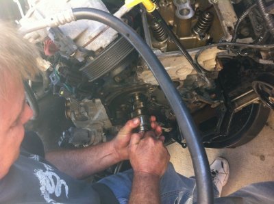

If your just doing a cam why take the heads off? I'm not super knowledgable about engine work but looking back on my swap it really wasn't bad at all w/ the heads still on, but I was also lucky an had access to the miller tool

Yea I called my dad (32 year mechanic) he sais just take the intake manfiold off and ill be good to go

Heads an intake still on

ST-8

A better shot. Sorry for the pics being sideways.

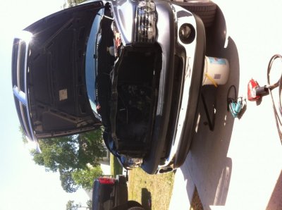

Thanks for the pics st-8, looks like you ripped off the front end haha

Thought thats what you meant I never have checked that truckin I never really understood what to look for.. An Davy the only thing removed from the front was the radiator an fans. Kinda weird seeing te front of your truck with a gaping hole.

Yea I can imagine even weirder how much space it actually takes up hahah
