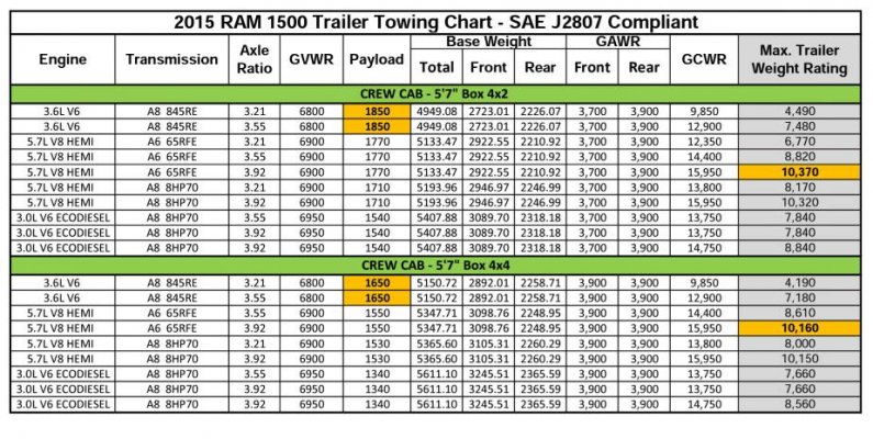

I purchased a 2015 1500 Outdoorsman with a V6 and I believe 3.21 gears. Has factory 20 wheels with new tires and 25k miles. I would like to eventually get a camping trailor and wondering how big I could tow. I really just want a queen size bed, a small refrigerator, sink and possibly ac. I would be towing it in some mountainous terrain on occasion. Do you guys have any suggestions on what I should look for?

You can look up your build sheet to find out axle ratio, Outdoorsman are supposed to 3.92, but that is not always the case and was not an option for the V6 gasser.
This is the SAE towing chart for your truck: 92c3a8b4fc254645531234d63152540d.jpg

Pick out a travel trailer that fits within your towing capacity. Most of the ones that you can tow with your truck are going to be in the 14 foot - 20 foot range depending on how many slides they have.
Figure out what your truck weighs with you, passengers, gear and a full tank of fuel in it.
Then figure out how much a trailer weighs with your gear packed in it.
With the load in the trailer, estimate the tongue weight. This will be added to your truck's total weight.
Add all the weights together.
Now look at the image pasted above to see if that weight is above or below your gross combined vehicle weight rating.
