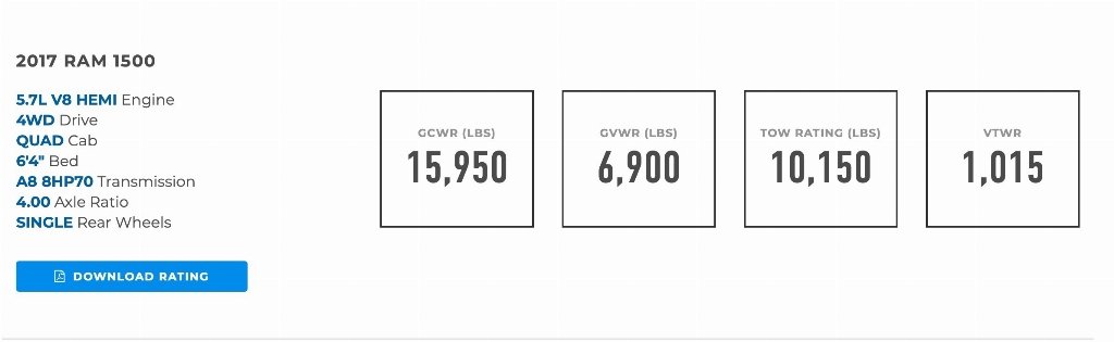

Tow table for 2017 shows your trucks base weight as 5220 lbs or there abouts.
Your CAT Scale showed you were already at 7060?
if so, you are already over your GVWR of 6900lbs without adding any tongue weight.
So, no, if you wish to stay within your trucks stated limits, then you can not pull any trailer and need to dump some weight from your truck, as it sits.

GVWR 6900 GCWR 15850 GAWR 3900.
Weight 7060 Front 3540 Rear 3520.
So you are over GVWR but under GAWR and this is before a trailer.
You say you weighed your truck at 5452 and you weigh 200.
Your weight was 7060 but your guesstimate is 6950(that is 90 pounds)
So, I am still not sure what your 200 pounds is you say you are missing.
6900 minus 5252 is 1648 payload, which is phenomenal for a half ton.
What does your yellow payload sticker on the driver's door jamb say?
You can tow a respectable trailer, you just can not haul while towing.
This is my philosophy on towing and why I have a 2500. I haul while I tow and haul more than I tow.
A 1500 can tow, but it can not haul and tow.
Check over the numbers I have here from your posts, get the payload from the tire and loading sticker and then we can talk more numbers.
I come up with you are 90 lbs off not 200.
When it says max tow. That is your 5252 plus 370 minus 15850. You will never travel that low ever.
Max payload and max tow are 2 very different things and are mutually exclusive.
