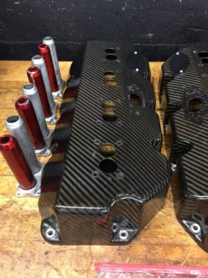

Wasn't sure of carbon fiber's melting point.

The carbon fiber material I'm using breaks down @ 500 Celsius which is 932 Fahrenheit . I have a design that I'm working on and I will start testing in a week or so . Thank yall for yalls feed back

The one I'm building right now is for the 6.4 hemi and it attaches up front on the passenger side and is easy to get to. I drag race and that was important to me for easy access and light weight. I'm hoping it will be less then a pound as we all know weight is everything in drag racing
