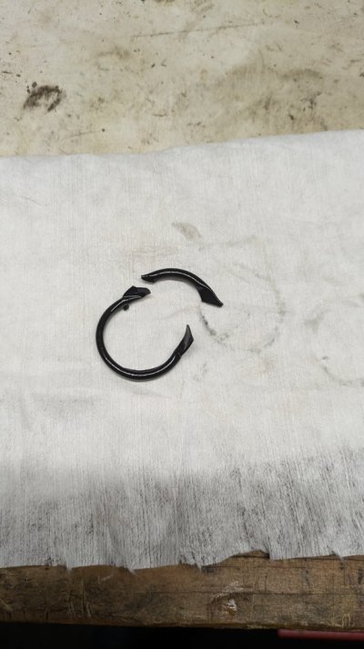

So a while back at 50k miles I went with the PPE pan on my truck. Today at 90k I decided on a fluid/filter change. Found the filter oring like this:
Clearly when I installed the pan I rolled and pinched the oring. Aside from the occasional rough 1-2 and 2-lockup when cold I didn't notice any problems, but clearly that's less than ideal.

Did you lube the O-ring before you installed it Jesse.I've had my PPE pan and filter off several times now,and have never had the old O-rings tear on removal

I can't imagine I installed it dry, wouldn't be like me. Lubed this one for sure and made sure to wiggle it in gently
I do definitely prefer the classic style trans filters that mount to the trans separately from the pan.
