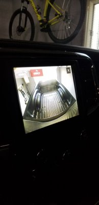

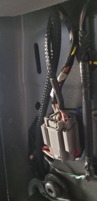

Looks nice! You did a great job on the harness. It looks like a factory install.

so pretty much you added the camera to the video input and used and ODB (wire ot bluetooth) to enable the feature in uconnect?

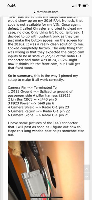

Hey!! Ive been looking for the pins that go into the radio connector. Do you have a link where you found them? And what pins spots you used? What cargo/brake light combo did you use? Factory? Any help would be appreciated

I'm with KCaudill - trying to source the connector pins (sockets, actually...) to add a camera. The connector holes are empty, nothing to splice the camera into. Everything else is in place, just need the female connectors to insert into positions 24 & 25 to fully activate my camera. The data are probably SOMEWHERE in the hundreds of pages for this DIY forum, but trying to search for just that info is proving difficult.
Edit: Found the data. "TE Connectivity 638551-3" available from Mouser Electronics in "Loose Piece" quantities. Web page restrictions prevent me fro posting a link to the actual page for some reason.
