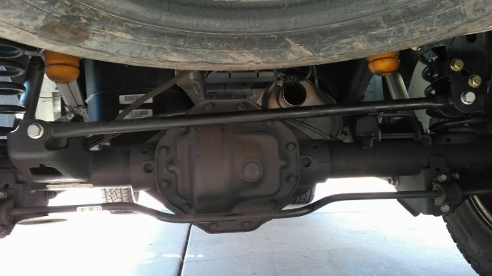

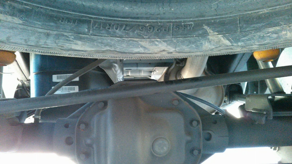

This is how the track bar has been these past 4+ years:

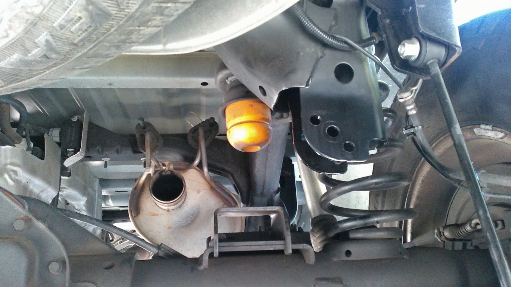

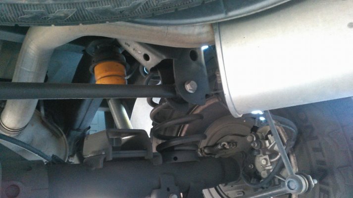

The Carli track bar drop bracket mounts on the chassis end (Passenger side, top) and lowers that end of the sway bar by a couple inches with no lateral change. It is held in place by five bolts of approximately 12mm diameter and this necessitates drilling four holes with a recommended 1/2" drill. One hole is existing on the chassis.
The general instructions are to support your chassis securely on jack stands (lifting the vehicle off the ground is not necessary, I only "unloaded" the suspension a quarter inch just enough to get the stands under the frame with some weight on them) and then carefully loosen both ends of the track bar, remove the top/chassis side bolt entirely. The track bar will likely be under a little bit of tension or compression so be ready for that, it's not dramatic. Let the track bar dangle and put your new bracket in place with the 5th bolt in an existing chassis hole and the track bar bolt through the chassis & new bracket. Use this as a guide to center punch your new holes, front and rear. It may be necessary to remove the rear section of your muffler/tailpipe. I found that easy here in Arizona, just a little Shin-Etsu grease on the rubber hanger to pop that off and a 15mm deep socket to release the clamp behind the muffler.
Remove the new bracket & drill the holes out to 1/2" (I used a 3mm metric drill first, then 1/4" then 1/2" and clean thoroughly, spray with rust preventative paint.
After the paint has dried reinstall the bracket with the 5 provided bolts, 10 washers and 5 lock nuts
The top bolt/nut/washers required a little creativity.
After everything is back in place the track bar may not want to immediately line up because it has followed an arc, so it might be necessary to use a ratchet strap between the chassis and axle to pull the top of the track bar into proper alignment. Not hard, but it does ask quite a bit of the ratchet strap so don't use your wimpiest one or one that's been frayed or knotted.
Post install the track bar on my truck is much closer to level, though not absolutely so. I'd imagine if I had a Laramie quad cab I'd have gotten a little less lift from the kit and the track bar would be spot on level.
