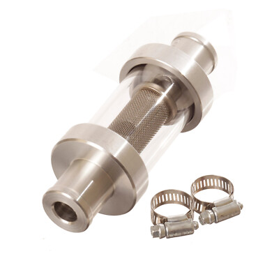

I get the concept of getting all the crud out of the engine, putting in a filter, etc. but it's worth mentioning the vast majority of people are good to go after a heater core flush. I think cases of cores clogging over and over again in a short period are the exception.
At least that's my experience and what I've read for the majority of cases here. I'm at 11+ years, 145K miles and on my second engine (so, two loads of crap) and my core only clogged after my radiator leaked and the core ran dry. I flushed for +/- 20 minutes with an air/water gun and am all good. Even if I have to do it every year or two (which I doubt I will) I'll just do that rather than spend a bunch of time/money on things that might not need to be done.
