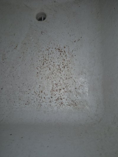

Just flushed my heater core due to low heat on driver's side and saw some tan sand in my sink when dumping the initial pan of coolant (after flushing out the coolant I just let the water run onto the ground and didn't notice any sand). I'm at 145K on my 2014 6.4 but had a replacement engine at 120K so I have two loads of whatever Ram is nice enough to leave behind. It was definitely tan in color. The filter would be nice but it was pretty easy to flush so I'll probably just do that, as needed.
