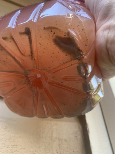

I hear you on the heater core flushing, I have some of the tools to do that job—- need to get the tool that adds air to the flushing water to give it some turbulence to carry out what is probably a pile of sludged coolant stuck in the bottom. I still am getting some heat on driver’s side— hoping I bought myself a little time with the flushing exercise.
I think that it’s cooked coolant mixed with corrosion of metals. The purple dye def separated from the coolant, I don’t think it magically disappeared and probably some of the crap is the dye. The coolant looked like the old HOAT orange from my ‘06 hemi.IMG_3954.jpeg
This was in every gallon I collected. I stopped collecting the radiator drop after 8 gallons, but collected a gallon on the 16th and it not clear water, and same specks and crap in it.
I think that it’s cooked coolant mixed with corrosion of metals. The purple dye def separated from the coolant, I don’t think it magically disappeared and probably some of the crap is the dye. The coolant looked like the old HOAT orange from my ‘06 hemi.View attachment 569528
Did you dump and rinse out your reservoir?
Thats where I found the majority of the crud in my 2015 1500 5.7.

EastWestHemi
Feb 25, 2017
187
125
Out West
2016 2500
6.4 w/4.10s
Yes, hoses off and flushed through the reservoir for 20 minutes…. What was left was not going to unstick from the sides. On the final drop, still producing that small sediment crap. My heat didn’t change on the drivers side, still very weak. I’m going to change my serp. belt, tensioner and pulley, maybe that will help the water pump produce more pressure for the radiator core… although that is probably just wishful thinking.
They probably tested the 6.4 for a year or two way back when, ran the truck all day everyday for thousands of miles and didn’t really give it the thousands of heat cycles and real world conditions a sold truck would see. Don’t think the 10 yr 150k on the coolant is right, but did think that refreshing the system a couple times would do the trick….. it didnt— here I am at 91k miles with a plugged heater core.
