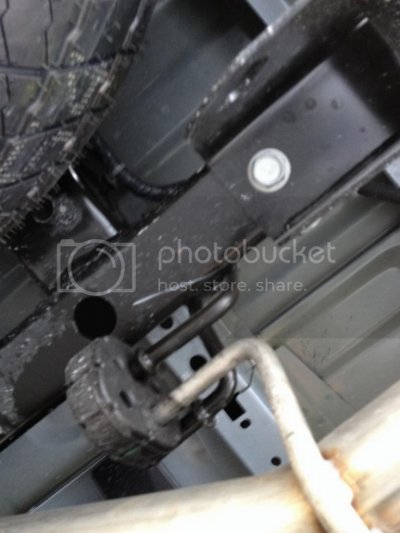

Fits Regular cabs fine. Had to trim about .5" off the end of the tailpipes to get the tips to tuck in better. Also the Passenger side was about 3" lower...So I have to bend the 1 portion of the hanger out of the way, and reposition the isolator. Fits great now tho.
Very little work needed.
