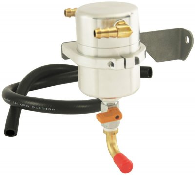

Any pics of yours? Interested to see the Moroso

i can get more pics if needed but it bolts to a bolt on the rad housing which i like versus the ones that bolt into a hole on the head. both work. i did buy some hydraulic hoses as someone suggested but couldn't get the damn things on so i went with the hoses in the kit which are rubber not vinyl. they came with the kit. i'm sure moroso provided hoses that are suitable. no clamps are needed like some catch cans seem to have. there's about 16 lb of vacuum in our system. the hoses don't need clamps and while very snug can be pulled off with a bit of effort if i want to do anything with the catch can. the guy who sold it to me has one on his mustang for 3 years. he said he has removed it once to give the filter inside a clean and run some cleaner through the hoses, but he said that was just a thing he did. there wasn't any issues that were causing him any concern.

this is what it looks like otherwise. only thing different on mine is i added a straight down adaptor and a 3/8 inch i believe fuel hose to drain it out behind my bumper. the hose is clip tied through a bumper bracket i believe and is about 1/2 an inch below my valance line. i open the valve, have an coke bottle in the garage and drip drip drip

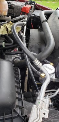

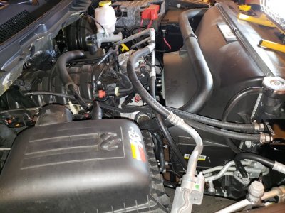

Does the crankcase vent tube now omit the air cleaner all together? Asking because I have a K&N cold air intake and the crankcase vent tube attaches under it

if i understand your question correctly, this goes from the pcv valve direct to the throttle body. i still have the tube that goes into my stock air filter housing. i don't know much about snorkel and modern air systems. lol
Oh ok. I wasn't too sure from your picture. Thanks for your help bud

sorry. yeah i could post more pics but don't have any on the phone except that currently. my longest tube just runs along the injector rail from the pcv to the left side fitting in the picture. short tube to the throttle body of course. apparentlly some of these cans have a specific in and out but the ones i've seen like that are labelled. the moroso anyways doesn't matter which goes where. i plumbed it exactly as per the moroso instructions which are very good. it drains, i'm happy.
