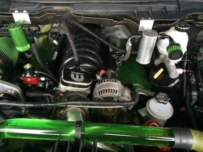

It totally depends on what type of catch can being used:
the standard on a hemi is a sealed catch can that is mounted in-line with the PCV system and remains closed loop and when it gets full you don't recirculate back into the crankcase, you spill liquid oil/water directly into the intake manifold which is a bad thing.
Vented catch cans are used when there is no vacuum source and attempts to keep the crankcase at atmospheric pressure but requires blow-by from the cylinders to generate the outflow pressure. If a vented catch can gets full it will overflow directly out of the can to the atmosphere and can leak to ground. Vented catch cans are common on boosted setups.
Here's my old engine bay, the green can on the left is a sealed catch can, the silver can on the right is a vented catch can.

That is one sweet ass looking engine bay. That clear coolant hose is really cool looking.
