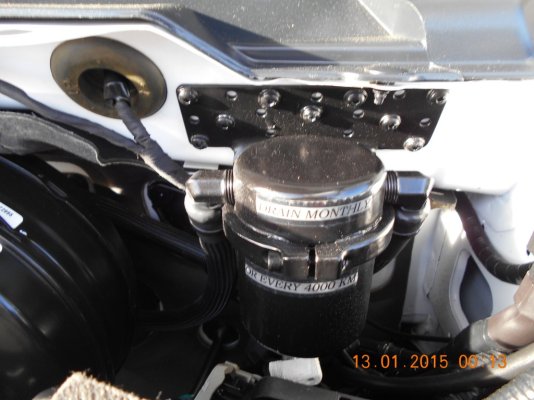

The worst engine i've ever had for filling a catch can was my old 13 with the 4.7,i used to dump it's can about every 1500 clics,and it would be half full by then.Hard to see as i'd painted it black,but it was in behind the battery on the drivers side of the brake booster.Just found another pic of it,that's easier to see

It blends in good there! I got one of the billet ones with the bracket that's on the side of the engine.
