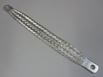

You need to ground to as many points as possible with wide braided straps,keeping as short as possible...Run power direct to battery to help eliminate some of that electrical and ferrites...
DO NOT do the one wire from any mount to chassie,doesnt work...
Keep in mind there is a electrical ground and and rf ground..
