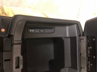

I have a 2015 Ram express with a jump seat. I just converted to a floor console. The floor console has a CD player in it. Im looking for the correct wiring harnesses. See pics

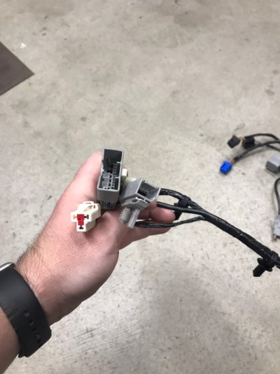

I have a harness. It’s for the full console. It will have a few extras because it was for a truck with rear heated seats.

Hello STecoD,
Do you have a picture of the harness? I'll be pulling the truck apart this weekend, so I'll know a little bit better what I need.

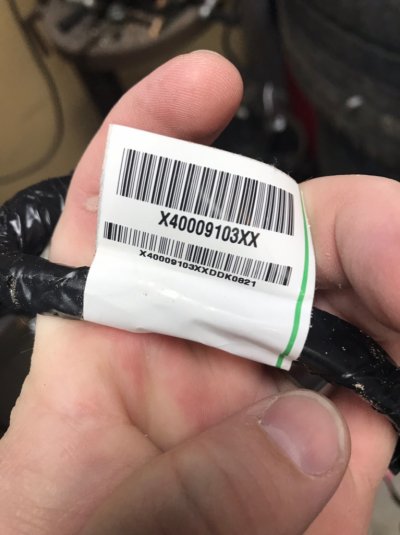

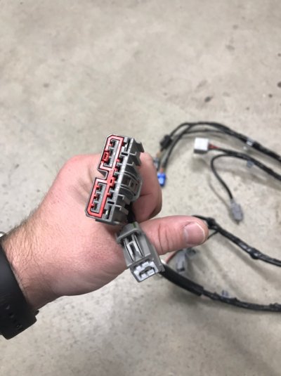

5054a67eb23c31f72568d45e0b54c235.jpg39d5c5896818b2d60a231195e1314c08.jpg9ae1b98e41687ea1781436f9ff13c97d.jpg074415083b706c3ce6e667a860f203ed.jpgb10a89f57b026249c0890dbb9e7cd778.jpg
