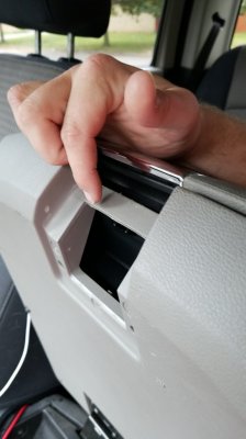

Hello everyone...
I have a 2012 Ram 1500 Outdoorsmen and the Lower Latch to my Center Console has broken and now it just flops around when i am driving... i have been to the dealership and they want 500 to 700 bucks for a new arm rest and i just need the lower handle/latch part. Does anyone know where i can find a new one or a better made one for the cobble stone grey colored interior
Thanks for the help in advance!

one new from mopar is like 30.00 bucks.replaced one a couple months ago if you are talking about the full console.even if its a jump seat latch should be avaliable.check mopar parts site or all mopar parts the should have a break down of the console and its parts.real parts people are few these days.

there is like three part numbers for the lower latch for the full console based on color it looks like.post a pick and i might can better help you.remember if a part doesn't show up for a 12 some parts up to a 18 are the same.so search a differant year model.

your interior is dark slate/medium graystone . i found part numbers 5rq83lu7ac canyon brown.5rq83dx9aa black and 5rq83la8ac diesel grey which is dark grey.19.00 to 25.00 on line around 30.00 list.09-12 had a differant shade of grey all 2013 up have the three colors i listed will keep looking to see if i can find the other numbers.

From what I can tell, that's if the front seat has the bench seat. from the pictures the OP posted, it looks like he has buckets up front.
