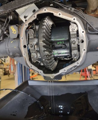

Brake cleaner really cleans. It drained gray hidden stuff.
I read that brake cleaner is hard on clutch pads ( witch we don't have ) and to use non chlorinated version ( less abrasive? ).
I used chlorinated because that is what I had.
Anybody knows if brake cleaning is ok?

my gasket on my 2020 was like new. The factory gaskets are nice gaskets and look like you can reuse them many times. I did put a light smear of rvt for differentials on both sides of the gaskets. has not leaked or seeped at all. Brake cleaner is fine. get both surfaces clean and dry as well. While you are at it put a different cover on. :)

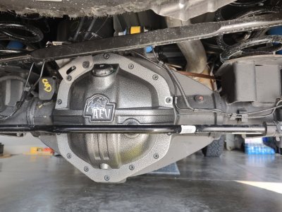

I would love to put the AEV diff cover on. But right now i am still broke from the wedding. So really dont see me doing any mods to this truck any time soon lol.
P.s. Did you get the front also? If not, any particular reason why?
No on the front and I only got the rear because AEV was not sure if they fit on 2019 and 2020 Power Wagons so they ask if I could/would stop by so they could check the fitment. They knew the front axle had not changed from previous years so that was not offered up. It is a bonus living close to their R&D they also tested out a Snap because there has been some issues using the snap on 19 and 20 Power wagons. the cover and the snap were compensation for my time which was pretty cool.

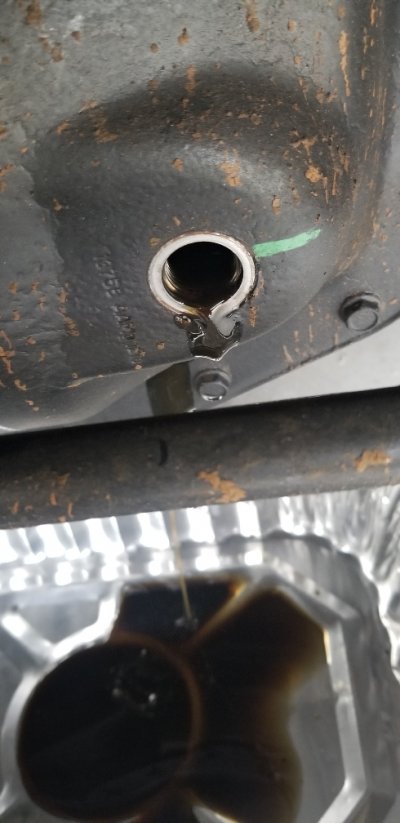

I like how the owners manual is like "fill diff to 1/4 below fill plug.. I've been sat here for 2 minutes after opening the fill plug... fluid is STILL coming out.. so tell me more about that 1/4 below RAM? Lol15ea137ff919149b35423ae1f23db123.jpg
Sent from my SM-G950U using Tapatalk
retired
Aug 19, 2020
2,172
2,792
montana
most stuff comes over filled from the factory. The diffs are probably filled before they are even mounted on the trucks. When you think about how little fluid ounce wise it would be at a 1/4" below the fill port not a lot. just depends on how your diff was tipped when it was filled.
