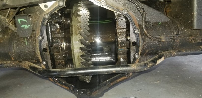

Yeah I ended up with about 3.5 liters coming out (dont judge me on the metric ****, it's what was on the can I poured into) lol.

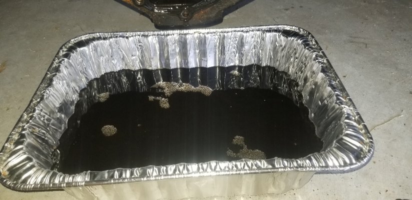

Anyway. First thing. I was pretty disappointed at the color of the fluid that came out. My old 1500 got its first diff service at 100k. And the fluid didnt look half as bad.

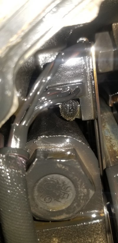

Next thing. There is a zip tie in the diff holding a group of wires... they didnt even trim the dang zip tie. So as I was putting the cover on, it got between the gasket and housing. Just a PSA for anyone else that does this.
Other than that. All went well. I just refilled it till it started weeping out. Then twisted up a paper towel and let it absorb some excess to get it just below the plug.
