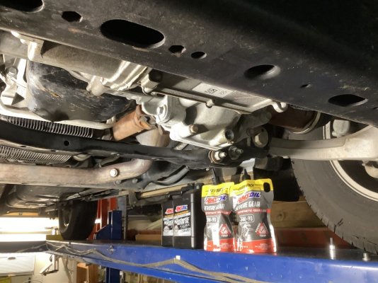

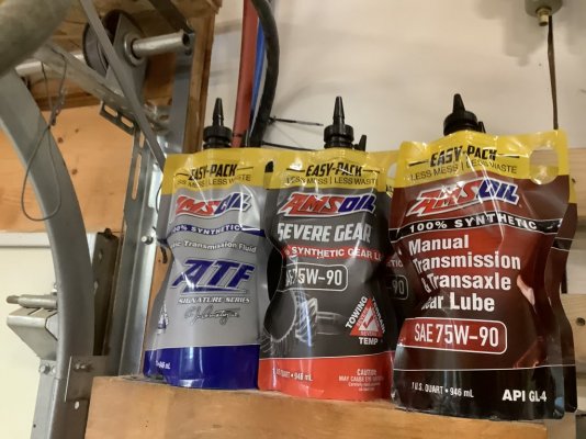

I did everything front rear trans and transfer at 10 k as its break in as I did with the engine the day I picked it up 8875BD1B-E1DA-4CF1-8D3D-243710558762.jpeg13939E0F-B5F5-40E8-ABB8-F745B9DF5C2F.jpeg71B2417C-7B60-4702-895E-EF1C69B209F4.jpegimage.jpg

I am a bit confused so is this the first time you changed it or actually the second time? If the second time and only 800 miles I am surprised there is anything on the magnet. good luck finding just the rubber gasket. My dealership said it was not available so you had to buy the entire plug...Seems they get chewed up everytime you pull the plug for some reason. When I changed mine early on I had nothing really on the plug at all.
I changed it at 800, and pulled the fill plug at 1700 because it was seeping a bit

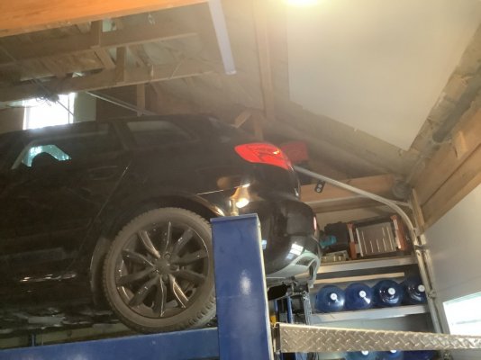

My vette guy helped me dial in the trans temp so I didn’t have to depend on the vehicle info for the trans fill temperature otherwise I do have a lift designed for the truck,A32E1566-4C01-4DDC-8AE9-A042263B737C.jpegimage.jpgwhich makes it fun for me.

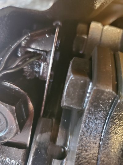

In late June I changed the coolant, transmission fluid and filters, front and rear locking differentials, transfer case, and spark plugs for routine maintenance at 95,525 miles. Except for a recall of the transmission solenoid at 10,000 miles no other fluid was changed. First change of spark plugs. Everything looked good with a very low concentration of filings on magnets. Cleaning off of the rear locking magnet filings was a futile effort.20220612_104529.jpg

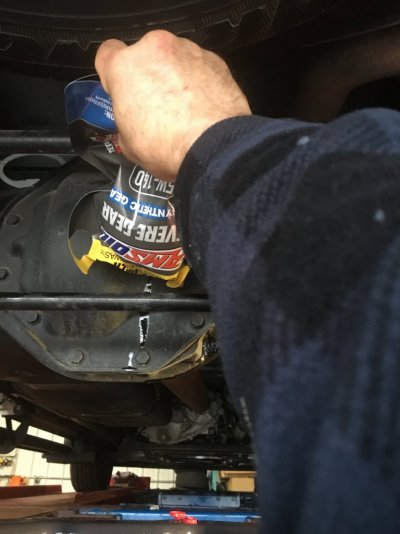

I decided at 25K miles, I needed to do the differentials. The oil in the front and rear diffs was black and had a bit of a sheen to it. I called a local place that carries Amsoil and she said the only 75W-90 Easy-Packs they had were held for other people, but she had the regular 1qt bottles at a lower price. I snapped them up and went home. Removing the rear was pretty easy. Moving the brake line bracket out of the way was the most challenging part. The reusable gasket was nice. Then, I had to figure out how to get the oil from the bottle into the diff. My cheap little transfer pump didn't work. The funnels that I had were the wrong angle. I was about to find a manila folder and make a funnel when I saw an old bottle of gear oil with the "nozzle top". I emptied it out and used that by pouring the oil from the new bottle to the nozzle bottle and then squirting it in the diff. It took me longer to come up with the solution to get the oil in the diffs than it did for the job itself. A 13mm deepwell for the rear and an electric ratchet made the job pretty painless. 10mm for the front.

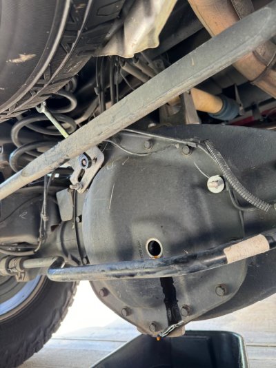

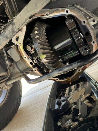

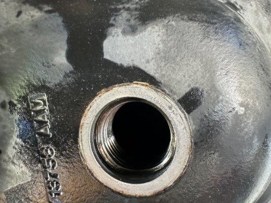

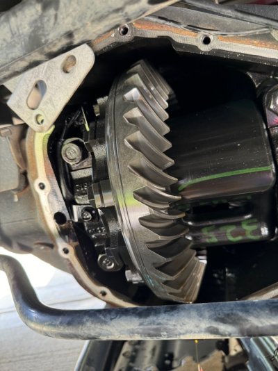

I thought it would be good to start fresh with all the fluids since I don’t have many records. Normally the rear lockers would take 30-45 seconds to engage but after the fluid change and cleaning the magnet, it would engage within a few seconds. Also the small vibration I would have some times while turning but coming from a full stop, seemed to diminish. First thing I noticed when I pulled the plug how much extra fluid was in the axle. It drained almost a quarter of a quart, which would make it about half a quart to 3/4 of a quart high. The truck must’ve been slightly off level to be able to handle the extra oil. Thankfully, it was just dark brown. No water present. It took 4.5 quarts to get back to that fuel line when I finished.
