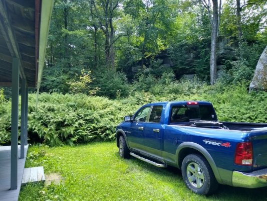

Sooo, I'm finally getting around to changing the differential fluids on my 2009 TRX4. It's only got 84,000 original miles but they've been hard ones! The truck was never garage kept and I live up north in western New York where they love to salt the roads! I've done quite a bit of towing and ripped three sets of running boards off going off road (they're now welded to the frame). A friend of mine who owns a shop in the country suggested I go with 75w-145 full synthetic in both axles even though we're in a northern climate. I had short mileage originally because I lived close to work and only got out to the country sporadically. Now I'm retired and own two properties that are both over 100 miles away so I'm starting to pile up the mileage. I have the 3.92 LS rear in this so I know I have use that highly toxic LS additive in the rear. I just wonder If It is okay to use this oil in the front?
