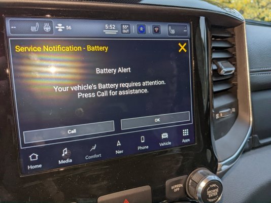

"Service Notification- Battery" Battery Alert, Your vehicles battery requires attention. Press Call for assistance.
Anyone else have this issue? I suppose it could be possible to get a bad battery from the factory, but seems odd.

Ok...I must confess, I had no clue what a Parasitic Draw test was! So those numbers were most likely not accurate. I just switched the meter to mA mode and put the red lead on the positive and the black on a bolt. I got beeps from the meter if I put the black on the negative! lol.
However, a new message appeared today on the radio ONLY. Here is the pic.

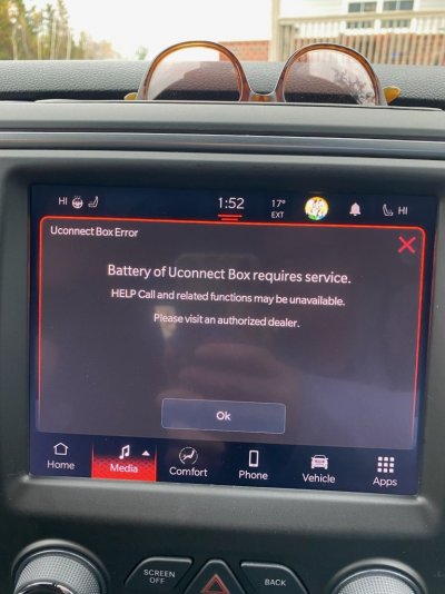

I am seriously wondering if this is a Uconnect/radio issue. Still no warning lights on the cluster. It seems like to the cluster every thing is good to go. Only the radio thinks the truck has an issue.

Got the Uconnect battery warning on my2022 Warlock . Only came up once but my radio is possessed. Will have dealer check it out .
