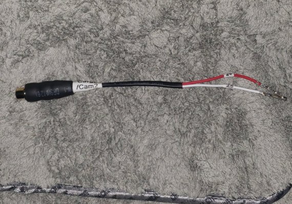

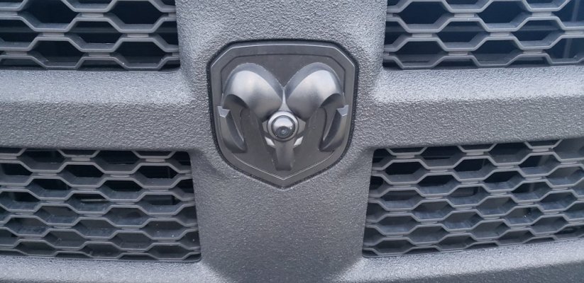

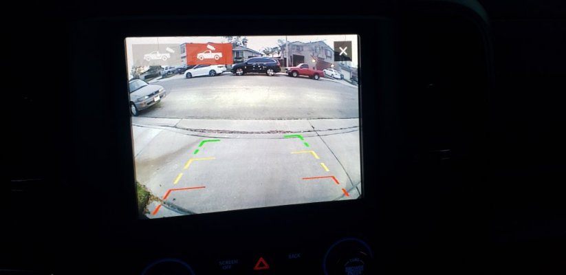

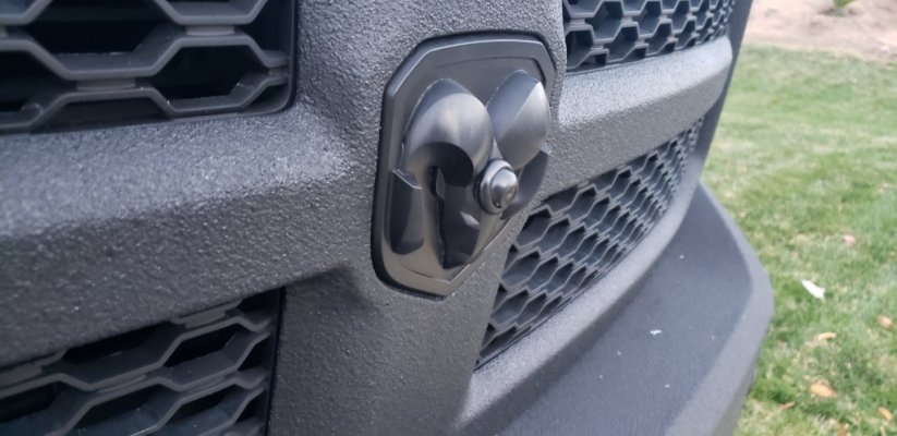

Well I got my pigtail harness from @Mpgrimm2 in the mail today so I can add the front view camera using the cargo camera input .... I ordered theCOOLINT CT-106S Mini 360 and should be here tomorrow .... I will post pics of where I mounted it and what it looks like when I am done ....
C
Nov 20, 2018
77
Riverside California
2018 2wd
HEMI 5.7 Revolution 4.88s
Well after a few hours of messing around with the pigtail harness I finally got the camera to work. The first time I pinned them to 24 and 25, ran the rca through the grommet and ran the power with a fuse tap to 101 which is a spare and only comes on with the key ...
The 2nd time I repinned them to 21 and 22 and still no picture just a black screen ....
The 3rd time I went back to 24 and 25 and BOOM ! I got picture !!!!!

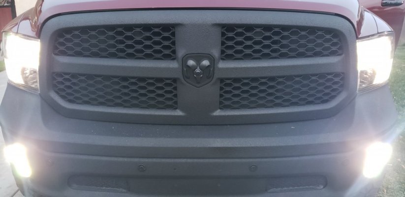

I finally secured all the harnesses back in place, ran all the lines nice and tight ... Then I drilled in the head of the ram emblem on the front grill, I had to drill through the back of the emblem and then through the actual grill to get the cables and the camera to sit flush without the wires getting crimped ...
Here are the pictures ...

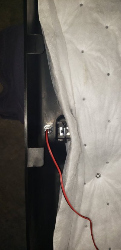

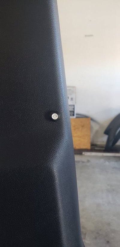

Got the Oznium footwell lights installed ..
I decided on mounting them on the b pillars so that the lights covered more of the visible area ....I was going to put them on the side of the rear cup holders on the floor but didn't like the coverage there ...
I still might get 2 more and put them on the sides of the cup holders though

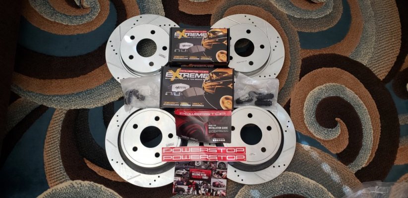

Well I finally got my Powerstop Z36 front and rear kit delivered .... drilled and slotted rotors with the Z36 Extreme Truck and Tow brake pads ... I was going to get the green pads many recommended on here but this was a good deal and just got the whole kit ...
Should have them installed this weekend
