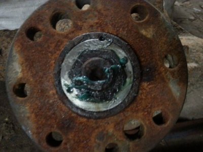

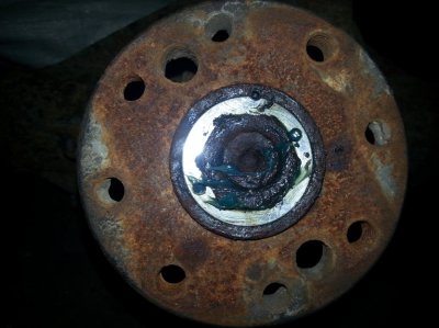

What do you guys think?

Do they come in other colors? What is the goopy stuff on there RTV?
Did you do that? Or has a dealership performed a repair?
Picture is unclear, did they or you use any type of thread locker, peen the threads? What all are you asking an opinion of?
If it was done by a Ram Tech, you should be all set, I have been told they know everything because they work there.
We jus wear tin foil hats.

That looks beyond saving. The one on my '92 RC looks better (MUCH better!) than that.

My Uncle make it. It is a collar over the bolt and in the bore of the yoke. That is grease to help it not rust. The collar is held in there by set screw threaded half into the yoke and the collar. And snug fit. So for the nut to turn not it has to shear the set screw or mush the collar or yoke. There is two holes with threads to pull on if it get seized in.
Just wondering what you guys thought of it.

Good fix, that's basically what the dealership does for the recall. I think it'll work just fine.
