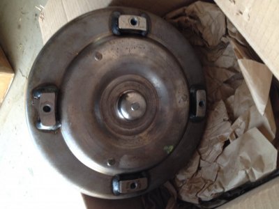

Billet converter
Hey there, I say pay the xtra $100. That billet piece replaces the 4 welded on tabs with 1 piece. Hope this helps
