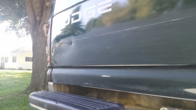

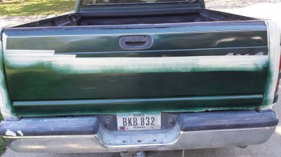

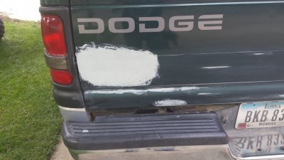

Here's a quickie of my story. I had 2 dents from a tow hook and a spot of surface rusty about the size of an old flip phone. Got it down to bare metal and feathered out, used s rust killer, added my body filler (forgot, need body filler too), sanded, primed, painted, and cleared. All with touch up touch-up cans. Not the way to do it. I had other imperfections where the black strip had been so i did those too. Where i ran into problems is i didn't want to remove my DODGE 4X4 stickers so i masked around em. Bad idea. Yout can see the masking lines and stuff in the finished product and all my clear peeled up.
