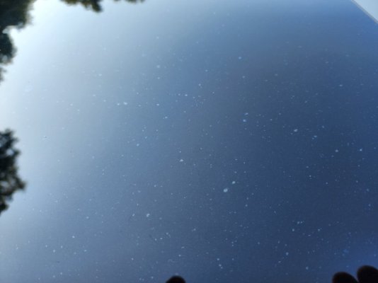

Pics of failure plz? On horizontal or vertical surfaces? What color? Thx
I'm not the OP, but this what the clear coat looked like on the hood of my 22 2500. Fixed under warranty:

What color is your truck? Did they repaint it or just perform paint correction? TIA
Diamond Black Crystal Pearl. They stripped it and repainted it. Seems to be a great match so far. It's been a couple of months since the work was done. Truck is in our RV building when not being used, so no paint fade.
