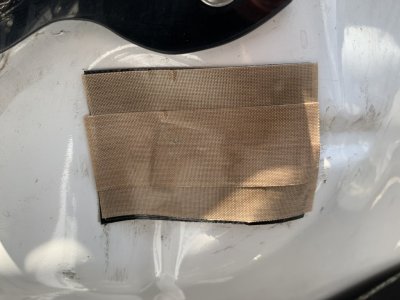

tidefan1967
Feb 3, 2018
3,012
5,098
Summerville, South Carolina
I know this is going to sound stupid but I also had a similar clunk when turning or going over bumps that sounded like it was coming from somewhere in the cab or right underneath the floorboards where the cab mounts are. In my case it turned out to be the hood making the noise. I adjusted out the hood bumpers some (I would start out with at least one full turn) and replaced all the tape that contacts the four bumpers with fresh teflon tape. For a temporary option I used duct tape and it worked fine. Try it you never know.
