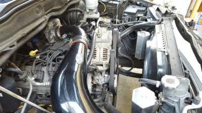

I would go with the flex a lite 180 or 183 setup. Also I would do this for the appearance under the hood not the “10 hp gain” I’ve ran the 183 for about 5 yrs now, sure aren’t gonna notice a bump in hp lol
