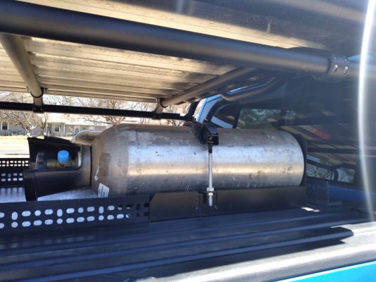

I had decided to go with CO2 instead of on board air. Airgas and Praxair no longer sell tanks to the public. They are still for sale on Amazon for now. I bought 2 new tanks but had to exchange them for filled tanks at airgas. CO2 refills tires faster than on board air and I wanted to be able to run an air impact wrench. The downside is $45 refill charges. 20220324_131215.jpg20220324_131142.jpg

I prefer Co2, super fast and quiet. I work at Airgas so it is also cheap to refill.
Make sure they are not charging you a hazmat fee. $45 is a little steep.

They are only doing tank exchanges and charge $45 per tank. Kind of steep imo.

Find a place that refills tanks. I get my 15lb filled for $25. I use a fire supply store.

I went with ARB a 2 tanks. My build out was $700 but it was a one time cost. And I too can run pneumatic tools. But if I went your route I would refill my large bottle at the welding supply and refill smaller bottles from that.

If you have a tank and a compressor you can fill it yourself with compressed air.
pneumatic tools are operable in adverse conditions inclement weather or flammable vapors
I don’t understand why Co2 instead of air.

Cause fast! 40s aired up in 30-45 seconds.
I agree when you have a tank it does air up fast, that’s why I set mine up the way I did. I also have a battery operated tire inflator to caring around in my wife’s car and it does the job, just takes a lot longer.

When you gear up to use CO2 to air up the tires, it kind of makes sense to throw in a cheap 1/2 drive impact wrench for the lug nuts. That's my thinking anyway.
