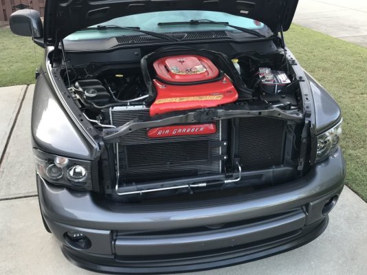

Take the bottom of the air box, out, then cut a 3" hole in the corner, using a hole saw.
Fetch a Basement type floor drain and remove the criss-cross drain catches.
Then, slap down some silicone, if you are so inclined, and put your drain, in the hole.
This is a picture of teh under side, of the cold air box, with the floor drain sticking out the bottom.

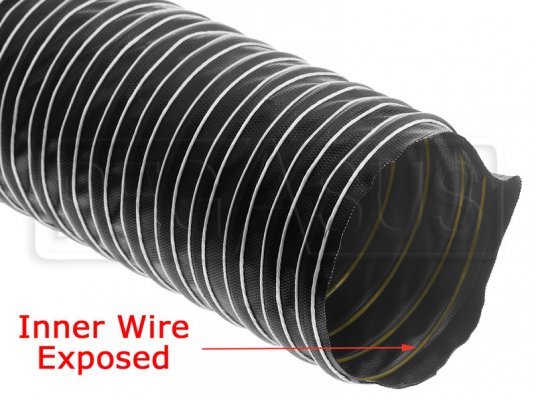

Slip the Aluminum flexible, painted black, Dryer Vent over the drains lip.
or go here adn get teh fancy hose
Tighten with a hose clamp.

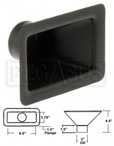

run the hose to this scoop, which will fit nicely on the passgr side of your radiator support. jsut cut a an opening for it and bolt it up.
Plenty of room for it.
Now you have a Speed Forced Air, Ram Styled, Cold Air Intake.
