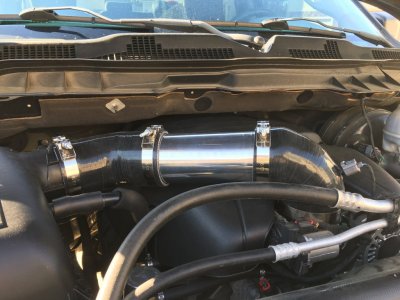

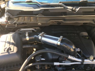

You mean like this. This is 3.5”/89mm inside diameter 45* and 90* silicone couplers and a 12” 3.5”/89mm outside diameter aluminum pipe. The 90* coupler at the throttle body has a 1/2” hole drilled out for the AIT sensor in roughly the same spot as the OEM tube. I put a little silicone on it for insurance but it went in super snug, twisting it in clockwise like a screw, so there was no damage to it nor opening up the hole unnecessarily. The 2 gripes I have is the 90* isn’t as tall as I would have liked so it pushes the engine cover down a little, and I will need to cut the aluminum pipe down an inch or 2 as there a is a slight distortion where the aluminum meets at the 90* coupler at the TB. Total cost for all was just shy of $40 shipped.
I haven’t had a chance to drive it yet, but hitting the gas in my driveway, the throttle response seems better. The only thing left is getting a dry AEM drop in filter (coming from @Nick@GotExhaust here on the 12th). I’m still puttering around with modifying the bottom portion of the air box in a similar fashion others have done with hose going to the grill or another spot outside the engine bay. I may also paint the aluminum pipe with some flat black high temp paint, but I kinda like it as is as it matches up to the other silver/aluminum under the hood.
I will update tomorrow with throttle response review.

Throttle response update:
Throttle response is definitely improved over OEM. Acceleration under WOT or just normal conditions (from a stoplight/sign) is smooth and linear. There doesn’t seem to be any sort of lag, “hiccup” or whatnot.
From a roll, again the truck accelerates fast and smooth. At WOT, the tranny kicks down perfectly to an appropriate gear and the engine/tranny seem to sync up more seamlessly, keeping the power where it needs to be in the sweet spot in the RPM range. When not accelerating at WOT from a roll (freeway speeds), the truck doesn’t seem to want or need to kick down the tranny more than the necessary gear (or 2) to speed back up to the appropriate speed (65 to 50 to 65).
On cruise control on the highway (ranging from 70-80mph), the truck rolls smooth and easy. As mentioned above, acceleration going up a hill is smooth and the tranny only seems to kick down the necessary gear to accelerate and maintain set speed.
All this is still using an OEM paper filter and the stock air box, I believe there will be additional improvement with the higher flowing AEM filter.
With as simple as $40 invested for some couplers, clamps and pipe I believe it was worth it for me and my truck. Results may vary though for you.

Damn that’s cool, you should post some links to where you bought those pieces
