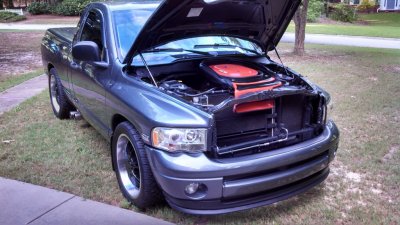

Apparently the guys who say they provide no horsepower gains haven’t had the right CAI. Popping in a K&N kit is almost worthless.
I’ve had two ‘Hemi-under-glass’ systems made by Vararam. These cold air induction systems made 22 rwhp on the Dyno. They looked and sounded awesome too! These kits aren’t the easiest to install but where are you going to get those type of numbers for a little over $300.00? I installed the Vararam V6 kit on my former wife’s Camaro RS and it was 33 bhp!

I think I’m the only ram member that doesn’t like the look of the vararam..... that’s just my personal opinion. I just do t like that big ol thing sitting on top like that. I prefer the traditional type air intake

Yeah, y'all are probably the only two guys in the world that don't like the way they look, but hey, that's okay. That's why they make chocolate and vanilla, right? I guess we like the "Old school" muscle car Hemi look, at least I do. And they're at the top with a couple more for performance too, what a combination!
