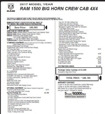

Thanks for the input! That's exactly what I was looking. Of course other first hand experiences help too.
Looking at my window sticker (attached) it looks like I have the Trailer Brake Control option but not the "Trailer Tow Mirror and Brake Control Group" but neither of them mention a transmission cooler. Honestly the only thing I can tell between these two groups is the mirrors as mine have the turn signals, lights, heater core, etc.

Trying going here Dodge - Contact Us, click on equipment listing (left side) and plug in your VIN. If you have tranny cooler it will show up. I'm guessing you do not. Also, get a decent Weight Distribution Hitch too.

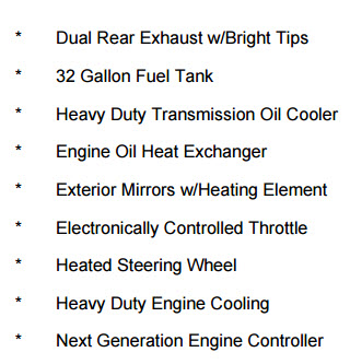

Thanks for that. I did find the attached on my build but I'm not sure if that's the default or if this is additional.

Basically, all 8-speed 5.7 Hemi trucks have the heavy-duty transmission and oil coolers already installed IIRC.
