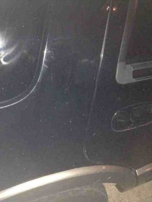

Hey guys, I came back to you all for your expertise.
On my expedition I have what appears to be spray paint and I can't get rid of it.
I used wd-40, clay bar, fükken wax, & eraser wheel. I can't get rid of it.
Any other ideas???
I appreciate the help!

Personally, I'd polish it off, and if that wasn't strong enough, I'd move to 3000 grit wet/dry and move up to polish and finish it off.

Try some Acetone! If paranoid just test a small spot first, betcha it works, that **** takes all paint off badges down to the chrome base and doesn't eat the chrome, standard procedure in the explosives world for clean-up and desensatizing of tools and equipment.
Edit: chewy;s method would work but time consuming and trickey if your not well versed in that kind of work, My second Option would be some BRASSO on a Rag!

I thought WD-40 was an acetone base that's why I used it first. Is it not?
