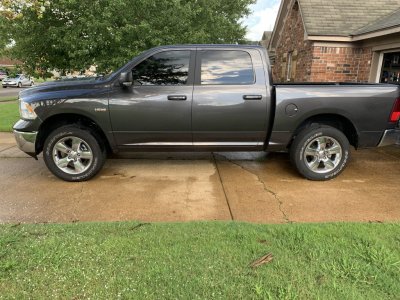

FF2CF91F-692E-4C3B-A0C1-C836A0B72610.jpeg 5265E5AE-ADAA-4371-BC4A-D73E1A2DE88D.jpeg Tires came in today! 275/65R20 Ridge grapplers. Icon C/O’s, shocks and UCA’s to go on when they get here. Thanks to Nick@Gotexhaust for answering my questions and setting me up with the parts I wanted! Can’t wait!

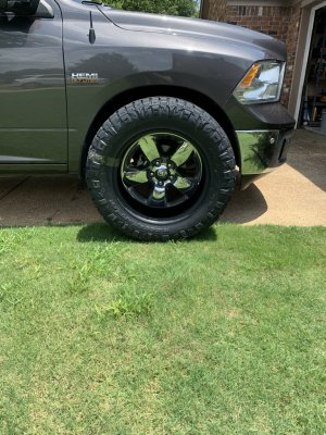

Gotcha. I made an appointment to get the tires installed Monday morning. I’m going to call the alignment guy while I wait. Tire shop doesn’t do alignments. Alignment guy doesn’t do tires. Ha! But he’s the best around here.

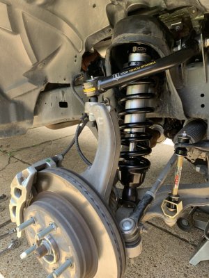

Copy that. I found the torque spec thread and took screen shots. Tq wrench is ready to go!!
if memory serves the top 3 bolts on the icons are torqued to 35LB and the lower bolt for the coil over is 150LB’s on the spec you got from here it will be higher for the top 45ish I think and the lower says 100lb.

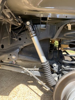

Have an appointment to get the tires mounted tomorrow morning. I just got back from driving it around and wow. I love it. Its firm but not harsh and on the highway about 80 it SMOOTH. It went together well, the driver side came apart really nicely. The passenger side upper ball joint wanted some Kroil and a little heat but separated nicely after that. Shocks were easy of course the driver side was tricky. I ended up just cutting a wrench and it worked great but I’ll be ordering the Thuren kit. Took me several hours but I took a few breaks because it is brutal hot here right now and I had a brisket going so had to keep an eye on the temps. Major thanks to Nick@GotExhaust (I don’t know how to tag). He was extremely helpful and I’m going to bet, beat anyone’s price!
