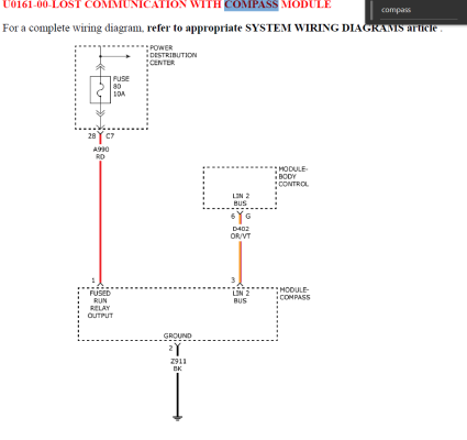

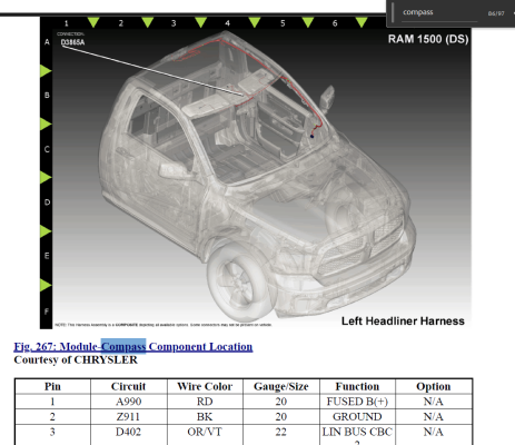

The pic looks like a 4th gen cluster but the OP profile says 2021. Assuming it's a 2013-1018 4th gen or a Ram classic, if it were my truck, i'd start looking in the factory service manual. Have you scanned your truck for codes? You'd need to do it with a capable scan tool to get OEM type codes, as they won't trigger the check engine light, and aren't typical OBD codes and a cheap code reader won't see them.
For my truck:
There are several compass related codes that could clue you in to the problem. Here are some from my 2013 factory service manual:
It says for B225C
The manual shows it to be in the overhead console:
Now, all that being said, this is the manual for my truck. If yours is different, you might have to find and buy a factory service manual your yours, or hit up AllData DIY for your specific truck's info.
For my truck:
It says for B225C
thank you. my truck is a 2021 classic
