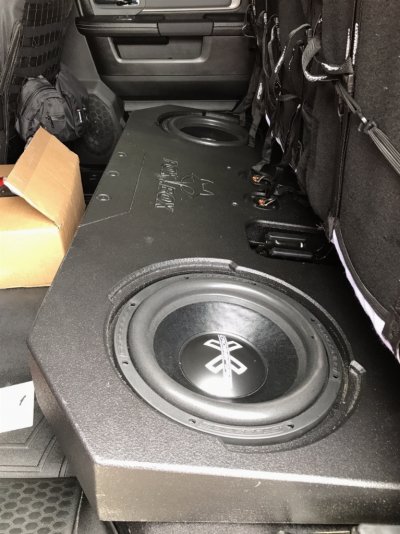

Here is my setup.
Alpine pxe850s dsp (12 channel amp 25 watts @ 4 ohm RMS). This is a signal processor and amp in one. It has a 31 band equalizer.
Kicker kx speakers in dash and doors. 3 way 6x9’s in doors with metra 1:2” spacer for front doors. Crossfire C5 800.4 amp putting 100 watts @ 4 ohms RMS To doors
Crossfire C5 1000 watt amp pushing 2 crossfire c3 12” dvc subs. 4 ohms wired in parallel to bring it to a 1 ohm load.
Fox acoustics box.
