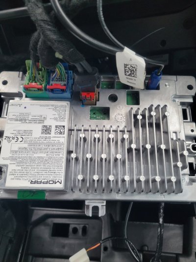

Ok...if the Ucrap 5 wont play xm for more than a week..guess I will McGyver my old xm portable unit into the Aux jack..does anybody know which is the sat plug on back..appears they changed colors? White plug behind that tag.20230405_092940.jpg

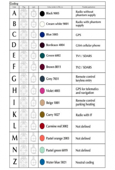

The colors are standardized on Fakra connectors. Here is a list with their purpose.

Have to pop the radio out again...take a look...radio with phantom supply? xm blue is gps..no gps on my radio...still confusing...I guess pull on off..if signal goes dead..thats xm antenna...I have the sharkfin antenna fyi.
Are they still fakra connectors? If I'm not mistaken, blue is also a neutral/universal key fakra so it may be on your blue connection.

I will know Tuesday when I pull things apart again..hard to believe they put a whole new wiring harness in..unless I poke around and dig and find an adapter hidden in there.
