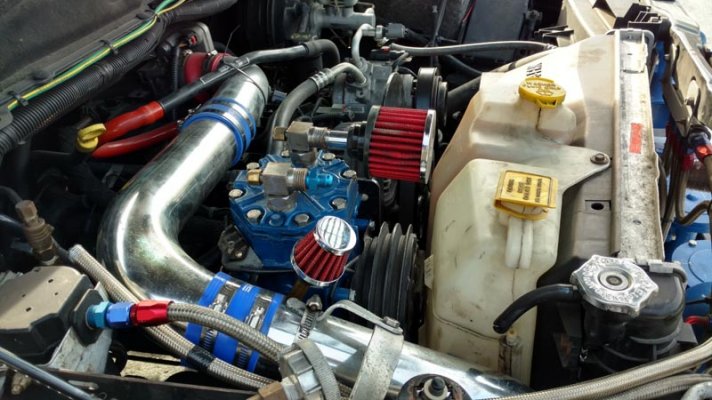

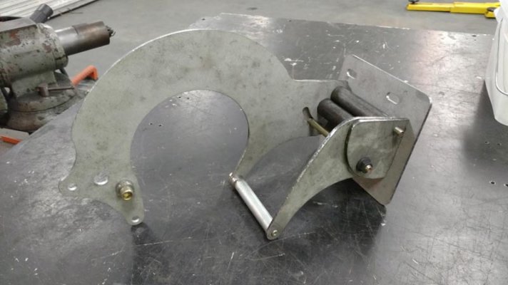

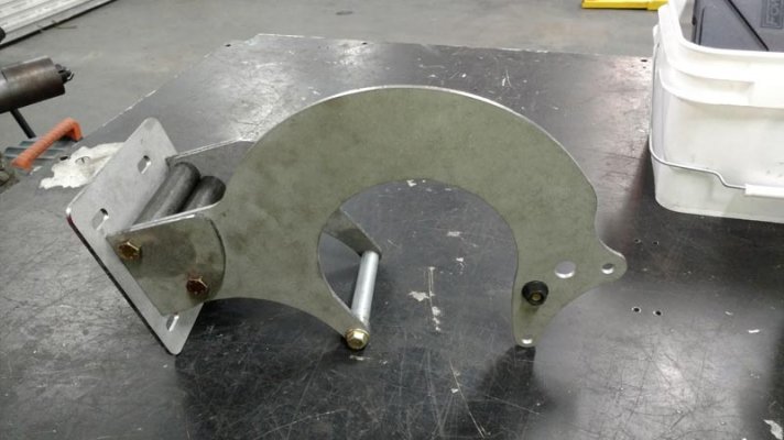

Here is my Nathan Airchime K5LA Train Horn Setup: There is a regulated tool port in the engine bay
and another with the full pressure of 200psi at the Tool Box in the Bed.
I had a Viair on my 2008 Big Horn. There are two 4.5 Gallon Aluminum tanks on the Frame rails.
It took 23 minutes to fill the tanks from 0 to 200 psi. I later picked up a York 210 AC compressor
from a 1973 Mercedes and made Brackets to mount it to the Hemi. I used a Hybrid Pulley on the
Alternator. Half Sepentine and half V Belt. This setup would do the same Tank fill up in 3 minutes
at idle. I plan to use a Sanden Compressor on my 2021 Laramie EcoDiesel.
