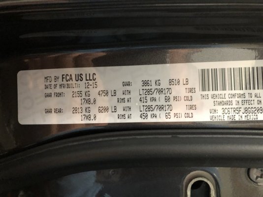

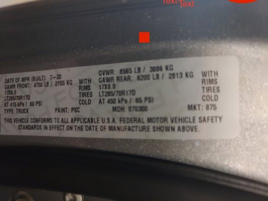

pw and nonpw 2500 arent the same front. the passenger side of the pumpkin and passenger side short tube are different and thus the lower 4750lb fawr, versus the 5600, 5750 and 6000 of a regular 2500 . these differences are very easily seen if you drive your pw to any dealer and park next to a regular 2500 and look underneath.
i do believe but cant say for 100%, the internals of all 2500 and 3500 9.25 fronts are the same ( gears, bearings, shafts, steering ujoints , etc)
maybe they are different because you have an older power wagon and in 2019 when they updated the body, supposedly they did some updates to the axles. A simple search on the internet will reveal the fact the 2500 and 3500 have the same axles with the exception of the cummins HO having a bigger rear differential. The springs are different which will change the axle weight rating. From a manufacturer perspective there is no reason to make multiple different housings if the ring gear is the same.

all pw from 2014 to this very day use a 3.5" OD short tube out the passenger side of the pumkin. nonpw 2500 and 3500 are 3.8" OD of that same tube. this is significant in terms of the housing rating. drive your 19+ pw to any dealer and compare it to any nonpw or 3500 and you will see.
some times its easy to take internet literature as correct but many times its wrong.
Hmm, my 2019 PW has a 6000 lb front ….

red arrows shows the area where its different

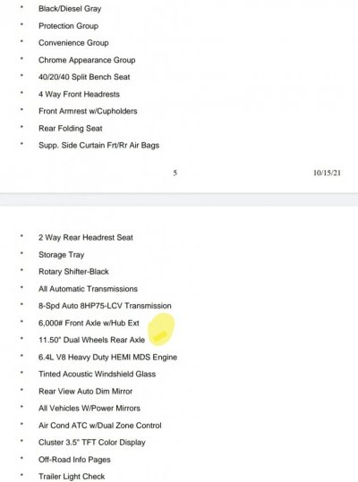

I bet you wouldn't admit defeat if I went to the dealer and measure it myself. Build sheet says 6000# axle because all 2500 and 3500 have the same front axle as indicated by chrysler themselves.
I will try to go by the dealer before work tonight to measure that for you with pictures of course.
Didn't the Power Wagon get the larger 11.5 rear axle beginning in 2014 through today? My 2016 Ram 2500 Tradesman with the Power Wagon option in Colorado looks awfully a lot like the same rear axle assembly of our 2014 Ram 2500 Laramie Cummins 4x4 in Wyoming. Got to verify those short tube diameters the next time that we get both trucks in the same location.
Build sheet claims 11.5 rear axle. All non HO Cummins trucks have same rear. Supposedly the power wagons have tuffer axle shafts.
crazy jerry
Apr 5, 2016
1,306
921
WY
well ive already measured them. but yes please do go get some photos so you can see for yourself

Power wagonScreenshot_20211015-121310_Gallery.jpg3500 gasserScreenshot_20211015-121244_Gallery.jpg2500 diesel Screenshot_20211015-121203_Gallery.jpg
OH MY... is that the same axle on 3 completely different trucks.
