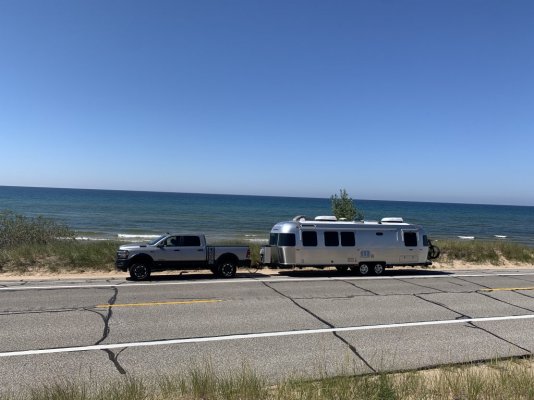

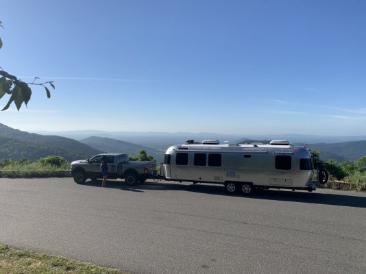

e rated bfgs and a Hensley hitch unless you have a 5th wheel. Stiff and solid@74mph Just maybe bring an extra gas card. 8.6 in mountains. 9.6 otherwise, prob better if you go slower . Change the tires to e rated and if it sways get a Hensley or pro pride. If it sags put in air bags. I didn’t need them. That is a 2018 30 classic ( which is really a 31 or 32 depending on who you ask) and in those photos it had 4 mos of crap in it. Tools, generator, 3 seasons of clothes books, bud lights, bikes, pots,pans it adds up - has to be 10,500 The 35s cost 1 mpg.
