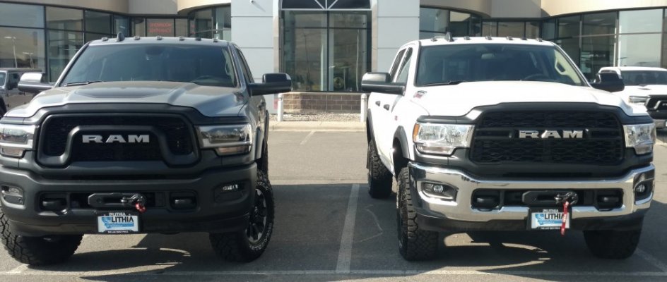

Over the weekend we got our two Rams together out in Wyoming and looked at the suspension of our 2014 Ram 2500 Laramie Cummins 4x4 to our 2016 Ram Tradesman Power Wagon. Same body style on both trucks. GVWR Front of 6,000 vs 4,750 pounds, rear 6,500 vs 6,200 pounds. We noticed the smaller diameter difference in the front axle housing dimensions. The most noticeable difference was the front lower control arms which are gargantuan on the Cummins truck and wimpy on the Power Wagon.

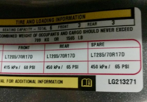

If you want the maximum payload with a Ram 2500 the configuration is a Tradesman with the sole option of the Power Wagon package. Options decrease the payload capacity.
retired
Aug 19, 2020
2,172
2,792
montana

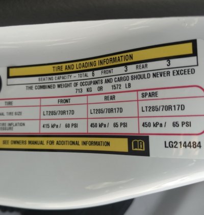

my 2020 PW with level 1 equipment has a payload of 1565 lb.
retired
Aug 19, 2020
2,172
2,792
montana
and this is the Tradesman with pw option I almost bought. not a lot of difference.
