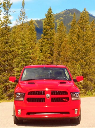

The Sport grill is fairly restrictive to airflow,a few guys have said they noticed a bit of a temperature drop by swapping to the honey comb grill.I swapped my Sport grill to the Honey comb grill,and personally like the look better,the inserts are an easy swap.

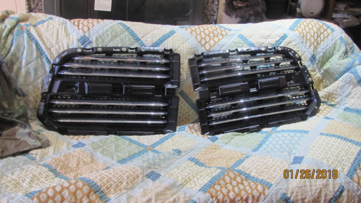

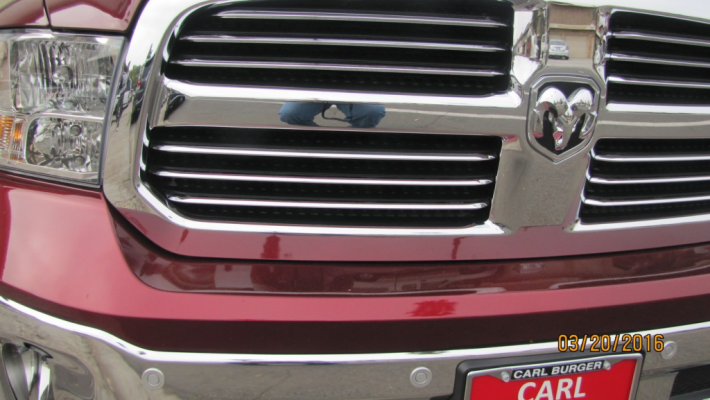

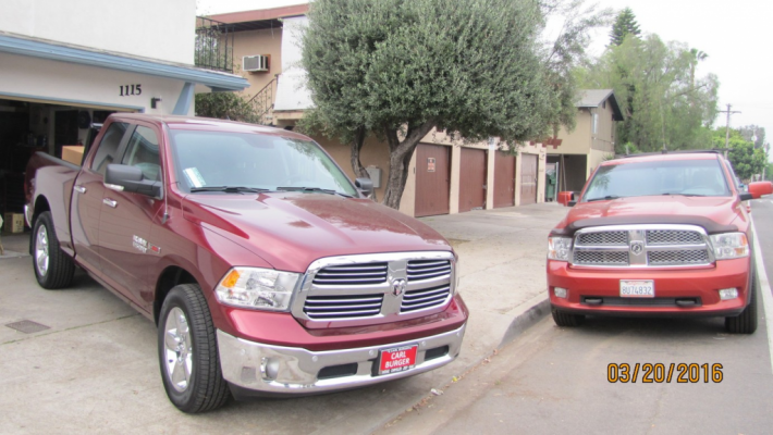

To get my honeycomb grille, i bought a new unpainted grille from a jobber. Then i removed both grilles inserts & compared the two side by side.
In the end, i kept the Chrome Surround & had the honeycomb inserts painted black.
The Chrome Surround is the only chrome on the exterior of my Ram

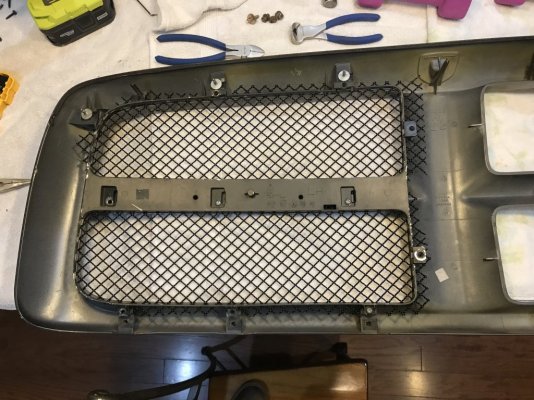

I did my own with powder coated aluminum woven wire mesh.
I removed the inserts, cut the louvers out and used the frame to sandwich the mesh.
I then cleaned up the interior by trimming off the excess mesh on the inside.
Rock solid too.
